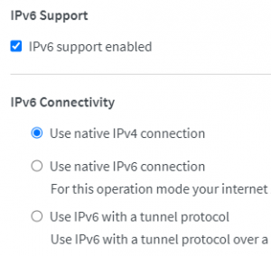

Hi, sorry for the confusion.
I had disabled IPv6 that's why the 2nd screenshot only shows a IPv4 address.
Now, I have turned IPv6 support back on, set it to use native IPv4 connection:
I now have IPv4 and IPv6 addresses, where the IPv4 is not tunneled:
  • Dual Stack on Fritzbox 6591 Beitrag #11

If I chose native IPv6 I get the following on IPv4
FRITZ!Box uses a DS Lite tunnel, AFTR gateway:....

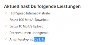

I ended up ordering the FritzBox and the Komfort option because I asked for DualStack. I presumed that If I am getting IPv4 and IPv6 addresses and I can connect to my workplace via VPN, then I don't need additional configuration. Or am I wrong? Still, when I go to my account on the Unitymedia Kundencenter, it says I'm using DS Lite
  • Dual Stack on Fritzbox 6591 Beitrag #13
The account details on the unitymedia Kundencenter are wrong for many people. Don't trust on this info. You can only rely on what you see on your device. If you still cannot get native v4 and native v6 I would ring them again and ask for Dualstack activation on your plan. Your device needs to restart for this to take effect though but on a rented device this is normally done from the remote end (TR-069).
He gets native IPv4 and IPv6 as we can see at the screenshots. But the strange thing is that this seems to be working only with the nativ IPv4 setting. Yes, normally dual stack is working with both settings (nativ IPv4 or nativ IPv6).
