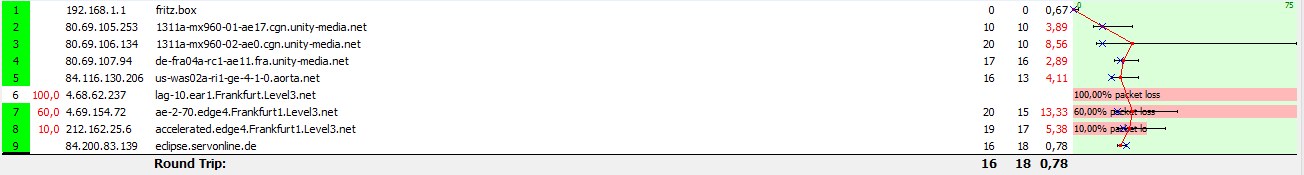

Schau mal z. B. mit:
<i>
</i>mtr -4nr -c 10 -i 2 <IPv4-Adresse-IRC-Server>
(oder gleichwertig) wie zuverlässig icmp-request/reply zwischen IRC-Server und IRC-Client ausgetauscht werden. Evtl auch mit:

  • Schlechtes internet - Hilfe Beitrag #8
hab linux nur in vmware installed:
test1:
fdsfsdfsdfsdfsdf@fdsfsdfsdfsdfsdf-virtual-machine:~$ sudo mtr -4nr -c 10 -i 2 irc.german-elite.net
Start: Mon Nov 10 13:13:15 2014
HOST: fdsfsdfsdfsdfsdf-virtual-ma Loss% Snt Last Avg Best Wrst StDev 1.|-- 192.168.216.2 0.0% 10 0.2 0.2 0.1 0.3 0.0 2.|-- 192.168.1.1 0.0% 10 0.8 0.8 0.6 1.5 0.0 3.|-- 80.69.105.254 0.0% 10 56.0 60.7 50.4 90.8 11.2 4.|-- 80.69.105.253 0.0% 10 57.6 66.1 52.7 126.0 21.4 5.|-- 80.69.107.94 0.0% 10 67.1 64.2 55.7 71.2 4.5 6.|-- 84.116.132.170 0.0% 10 57.5 62.3 57.5 70.2 4.0 7.|-- 193.159.164.161 0.0% 10 60.5 64.7 60.5 69.5 3.3 8.|-- 62.154.46.186 0.0% 10 79.9 78.3 71.1 88.1 5.0 9.|-- 62.157.250.34 0.0% 10 69.5 71.1 57.5 82.6 7.8 10.|-- 85.214.0.147 0.0% 10 97.6 73.2 59.2 97.6 10.1 11.|-- 85.214.33.208 0.0% 10 75.0 71.6 68.5 75.0 1.9
test2:
HOST: fdsfsdfsdfsdfsdf-virtual-ma Loss% Snt Last Avg Best Wrst StDev 1.|-- 192.168.216.2 0.0% 10 0.1 0.1 0.1 0.2 0.0 2.|-- 192.168.1.1 0.0% 10 1.3 1.1 0.7 2.9 0.6 3.|-- 80.69.105.254 0.0% 10 57.5 59.5 55.7 67.2 3.2 4.|-- 80.69.105.253 0.0% 10 58.5 60.4 50.0 76.4 6.8 5.|-- 80.69.107.94 0.0% 10 61.6 63.2 53.0 68.9 4.3 6.|-- 84.116.132.170 0.0% 10 59.8 61.9 53.3 69.9 4.6 7.|-- 193.159.164.161 0.0% 10 68.1 65.3 59.4 73.2 4.4 8.|-- 62.154.46.186 0.0% 10 81.6 75.4 58.5 81.6 6.4 9.|-- 62.157.250.34 0.0% 10 68.8 69.3 62.2 71.8 2.7 10.|-- 85.214.0.147 0.0% 10 252.2 95.1 66.2 252.2 56.8 11.|-- 85.214.33.208 0.0% 10 69.8 70.0 57.5 76.5 5.3
test3:
HOST: fdsfsdfsdfsdfsdf-virtual-ma Loss% Snt Last Avg Best Wrst StDev 1.|-- 192.168.216.2 0.0% 10 0.2 0.2 0.1 0.3 0.0 2.|-- 192.168.1.1 0.0% 10 0.7 1.1 0.6 1.7 0.0 3.|-- 80.69.105.254 0.0% 10 60.3 62.0 53.3 98.8 13.2 4.|-- 80.69.105.253 0.0% 10 54.8 58.9 53.2 62.4 3.4 5.|-- 80.69.107.94 0.0% 10 57.7 59.8 53.8 62.9 2.8 6.|-- 84.116.132.170 0.0% 10 64.6 62.1 54.3 66.4 4.5 7.|-- 91.121.131.77 50.0% 10 85.9 68.6 57.4 85.9 10.7 8.|-- 178.33.100.244 0.0% 10 78.8 75.4 70.7 79.0 2.5 9.|-- 94.23.122.162 10.0% 10 73.4 90.3 71.1 177.1 33.7 10.|-- 178.33.38.42 0.0% 10 74.5 73.6 66.2 84.2 5.4
test4:
Start: Mon Nov 10 13:19:22 2014
HOST: fdsfsdfsdfsdfsdf-virtual-ma Loss% Snt Last Avg Best Wrst StDev 1.|-- 192.168.216.2 0.0% 10 0.2 0.2 0.1 0.2 0.0 2.|-- 192.168.1.1 0.0% 10 0.7 0.8 0.6 1.1 0.0 3.|-- 80.69.105.254 0.0% 10 57.9 63.3 54.1 114.8 18.3 4.|-- 80.69.105.253 0.0% 10 62.4 59.7 53.2 64.3 3.2 5.|-- 80.69.107.94 0.0% 10 66.0 60.2 51.4 69.1 5.5 6.|-- 84.116.132.170 0.0% 10 59.7 62.6 54.7 78.9 6.6 7.|-- 91.121.131.77 20.0% 10 64.8 66.6 56.9 80.2 6.4 8.|-- 178.33.100.244 0.0% 10 80.9 76.1 70.3 82.9 4.2 9.|-- 94.23.122.162 20.0% 10 91.5 89.8 61.5 144.2 24.7 10.|-- 178.33.38.42 0.0% 10 79.3 75.8 72.4 79.5 2.2
Verlust ist schonmal da

Latenzen per tracert : http://imgur.com/PKlBbAD
so oder so ähnlich hab ich das jeden Abend so zwischen 18 und 24 Uhr, garantiert aber so ab 8 Uhr bis 23 Uhr! Schreibe hier ja auch gerade nur, weil ich deshalb dummerweise nicht zocken kann (csgo).

Dank "PingPlotter" hab ich nun gesehen woher die Probleme kommen:

aber laut pingplotter tauchen die "Franktfurt" Server nicht mehr auf.
Pingplotter zeigt auch kein packet loss mehr an. demnach arbeitet unity da an irgendwas
