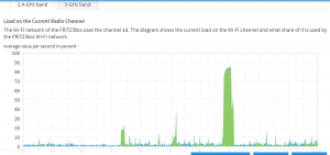

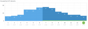

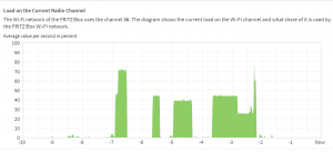

Actually, I've already switched from auto-channel to fixed channel so that avoiding more signal overlapping. For the two images below, one can find the status of 2.4GHz and 5GHz band. The peaks were from my wifispeedtest APP. So I believe it meant the signal was not that strong. I could clearly feel the speed going down when stepping away from 6660. The point is my last 6490 can cover my apartment quite well even though it was only 50Mbit/s, but now with 6660, it turned out to be quite different...
I have not tried any cable connection since all my PCs have no Ethernet port, and I never get one for myself, which makes me look stupid now...
I'm not sure this is the case, but I tend to believe this is due to the FritzOS version. Some people in this forum said there is a strong conflict between Iphone and FritzOS 07.22, which is the same case to my wife's iphone now.

using 5GHz wlan is fine, there is only one other network on the same frequency. In the box below you can see the strength of the other network using wlan channel 36 when you move the mouse above the wlan-wave-symbol (you can also see if one, two or more or all lines are blue (completely gray means other wlan network is below 20% what would be best).
