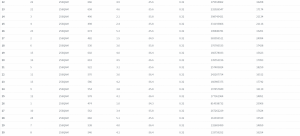

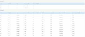

So nun die aktuellen Werte:
Nicht wundern die Fehler die es auf der Leitung gibt kamen durch mein fummeln an den Kabeln heute. ;)
Noch zusätzlich die Werte in Textform:
Single-Carrier Channels: 8 (4 currently active)
ID | Active | Frequency | SymRate | ChWidth | Attenuation | Power | Power16 | P-High | P-Low | P-DRW-High | P-DRW-Low | DeltaPF | Mod | Mux
| | [MHz] | [MHz] | [kHz] | [dB] | [dBmV] | [dBmV] | [dBmV] | [dBmV] | [dBmV] | [dBmV] | [dB] | |
3 | YES | 44.600 | 5.120 | 6400 | 16.717 | 38.021 | 32.000 | 49.500 | 17.000 | 37.000 | 25.000 | 0.000 | 64QAM | ATDMA
1 | YES | 30.800 | 5.120 | 6400 | 15.977 | 39.021 | 33.000 | 49.500 | 17.000 | 37.000 | 25.000 | 0.000 | 64QAM | ATDMA
4 | YES | 51.000 | 5.120 | 6400 | 15.595 | 39.021 | 33.000 | 49.500 | 17.000 | 37.000 | 25.000 | 0.000 | 64QAM | ATDMA
2 | YES | 37.200 | 5.120 | 6400 | 16.190 | 38.771 | 32.750 | 49.500 | 17.000 | 37.000 | 25.000 | 0.000 | 64QAM | ATDMA
0 | NO | 9.961 | 0.000 | 0 | 0.000 | 0.000 | 0.000 | 0.000 | 0.000 | 0.000 | 0.000 | 0.000 | er | ATDMA
Multi-Carrier (OFDMA) Channels: 2 (1 currently active)
ID | Active | First Subcarrier | Last Subcarrier | Active Subcarriers | Max Mod | Gain | Power | FFT Size
| | [MHz] | [MHz] | | | [dB] | [dBmV] |
0 | YES | 29.800 | 64.750 | 640 | 256QAM | 0.143 | 33.000 | 4K
1 | NO | 0.000 | 0.000 | 0 | 0 | 0.000 | 0.000 | None
ingle-Carrier Receivers: 32 (30 currently active)
ID | Active | Frequency | Primary | Power | MSE | CorrWords | UncorrWords | QAMLock | FECLock | MPEGLock | Mod | Annex
| | [MHz] | Capable | [dBmV] | [dB] | | | | | | |
29 | YES | 738.000 | ACTIVE | 6.70 | -37.356 | 47726294 | 9744 | YES | YES | YES | 256QAM | A
0 | NO | 0.000 | N/A | 0.00 | 0.000 | 0 | 0 | NO | NO | NO | er | B
28 | YES | 730.000 | YES | 6.10 | -36.387 | 68578430 | 10249 | YES | YES | YES | 256QAM | A
30 | YES | 746.000 | YES | 7.00 | -37.356 | 29450050 | 8127 | YES | YES | YES | 256QAM | A
27 | YES | 706.000 | YES | 6.10 | -36.387 | 71137164 | 10249 | YES | YES | YES | 256QAM | A
26 | YES | 698.000 | YES | 5.80 | -36.387 | 89346545 | 12897 | YES | YES | YES | 256QAM | A
25 | YES | 690.000 | YES | 5.20 | -36.387 | 150660247 | 15248 | YES | YES | YES | 256QAM | A
17 | YES | 626.000 | YES | 4.40 | -36.610 | 168028220 | 15661 | YES | YES | YES | 256QAM | A
19 | YES | 642.000 | YES | 4.40 | -35.595 | 231850563 | 17317 | YES | YES | YES | 256QAM | A
18 | YES | 634.000 | YES | 4.50 | -36.387 | 174238330 | 15863 | YES | YES | YES | 256QAM | A
20 | YES | 650.000 | YES | 4.30 | -35.595 | 256296129 | 17770 | YES | YES | YES | 256QAM | A
14 | YES | 594.000 | YES | 3.90 | -36.387 | 204591158 | 20011 | YES | YES | YES | 256QAM | A
22 | YES | 666.000 | YES | 5.00 | -35.595 | 180103580 | 16208 | YES | YES | YES | 256QAM | A
21 | YES | 658.000 | YES | 4.60 | -35.595 | 232269822 | 17174 | YES | YES | YES | 256QAM | A
3 | YES | 490.000 | YES | 2.10 | -35.780 | 399211139 | 21134 | YES | YES | YES | 256QAM | A
4 | YES | 498.000 | YES | 2.50 | -35.595 | 331577354 | 21116 | YES | YES | YES | 256QAM | A
23 | YES | 674.000 | YES | 5.30 | -35.780 | 150007892 | 15201 | YES | YES | YES | 256QAM | A
2 | YES | 482.000 | YES | 1.50 | -34.926 | 584655538 | 24094 | YES | YES | YES | 256QAM | A
6 | YES | 530.000 | YES | 3.60 | -35.780 | 176961851 | 17428 | YES | YES | YES | 256QAM | A
15 | YES | 602.000 | YES | 4.00 | -36.387 | 166766623 | 15623 | YES | YES | YES | 256QAM | A
16 | YES | 618.000 | YES | 4.50 | -36.610 | 139709898 | 17093 | YES | YES | YES | 256QAM | A
5 | YES | 522.000 | YES | 3.10 | -35.595 | 257705345 | 18250 | YES | YES | YES | 256QAM | A
11 | YES | 570.000 | YES | 3.60 | -36.387 | 242465379 | 16512 | YES | YES | YES | 256QAM | A
13 | YES | 586.000 | YES | 4.20 | -36.610 | 167176030 | 17742 | YES | YES | YES | 256QAM | A
9 | YES | 554.000 | YES | 3.70 | -35.780 | 197684013 | 16110 | YES | YES | YES | 256QAM | A
12 | YES | 578.000 | YES | 4.10 | -36.387 | 177548647 | 14851 | YES | YES | YES | 256QAM | A
1 | YES | 474.000 | YES | 1.10 | -34.484 | 815855839 | 25906 | YES | YES | YES | 256QAM | A
10 | YES | 562.000 | YES | 3.30 | -35.595 | 267547170 | 17624 | YES | YES | YES | 256QAM | A
24 | YES | 682.000 | YES | 5.10 | -35.780 | 162078711 | 15529 | YES | YES | YES | 256QAM | A
7 | YES | 538.000 | YES | 4.00 | -36.387 | 132744869 | 14850 | YES | YES | YES | 256QAM | A
8 | YES | 546.000 | YES | 4.10 | -36.387 | 133898944 | 16254 | YES | YES | YES | 256QAM | A
Multi-Carrier (OFDM) Receivers: 2 (2 currently active)
ID | Active | Frequency | Primary | PLC Freq | Power | MER | CorrWords | UncorrWords | Max Mod | Rolloff Period | Cyclic Prefix | FFT Size
| | [MHz] | Capable | [MHz] | [dBmV] | [dB] | | | | | |
0 | YES | 751.000 - 860.950 | NO | 823.000 | 5.10 | 35 | 1080916494 | 3190063 | 4096QAM | 256 (1.25 us) | 512 (2.5 us) | 4K
1 | YES | 175.000 - 236.950 | NO | 211.000 | -1.60 | 33 | 280336179 | 2035833982 | 4096QAM | 256 (1.25 us) | 512 (2.5 us) | 4K

Jetzt bin ich mal gespannt was du sagst @MartinP_Do
  • F6660 werte OK? Beitrag #54
Es gibt drei Möglichkeiten.
1) Bei dringender Notwendigkeit einer stabilen Internet-Verbindung würde ich eine Störung aufmachen, damit der Anschluss durch einen Techniker neu eingepegelt wird.
2) Wenn etwas Zeit ist, würde ich ein paar Tage warten, ob sich das wieder selbsttätig einpegelt.
3) Rückwegsdämpfungsfilter kaufen, und (wenn bei Deinen Gegebenheiten möglich) direkt am Verstärker Haus-Seitig installieren, oder zumindest in dem Abgang von dort zu Deiner Multimediadose ... z. B.:
3) würde wohl am Schnellsten gehen, dafür kosten 1+2 nix.
Aber vielleicht hat man in der Zeit vor Weihnachten nicht die Muße auf einen Techniker zu warten, oder möchte seine Kontakte aufgrund der Infektionszahlen minimieren ...
Zu 1) : Wenn ein Modemsendepegel sich um 10 dB ändert, dann sollte man (als Techniker) eher den Grund dafür suchen und nicht einfach den Verstärker verstellen (das kann zwar je nach Ursache im Endeffekt doch nötig sein, aber erst mal muss man rausfinden warum es zu der Pegeländerung gekommen ist).
Zu 2) Das ist die sinnvollste Lösung. Auch wenn sich da nichts selbständig "einpegelt", sondern eher die Ursache wieder verschwindet (oder beseitigt wird).
3) Bitte nicht!!!!
Externe Rückwegdämpfungsglieder am Verstärker oder (noch schlimmer) sonstwo in der NE4 sind Pfusch und in 99% der Fälle unnötig. Die Dämfpung wird im Verstärker eingestellt. Lediglich bei extremen Pegelverhältnissen aus der NE3 oder in NE4-Linienanlagen braucht man das, aber selbst das ist sehr selten. Deshalb ist das auchin Installationen nicht zulässig unter normalen Bedingungen.
und zu 4)
Ist es so schwer, einfach selbst nachzusehen ob die Pegel "im Range" sind?
Dass der Sendepegel von helldriver in Ordnung ist, nur eben recht niedrig, haben wir in seinem anderen Thread schon festgestellt. Dass sein DOCIS 3.1 Sendesignal "immer wegsackt" leigt nicht daran. Eher deuten die geposteten Pegel (zumindest aus dem anderen Thread) auf Ingress hin, woran das schon eher liegen könnte.
