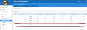

Servus Zusammen...
seit Kurzem Läuft das mit den fehlern auf 578Mhz aus dem ruder die anderen Kanäle sind soweit okay.. Strahlt hier DVBT2 in die leitung? oder hat die Box einen weg??
DOWNSTREAM
Frequency band: 108-1002 MHz
Latency: 0.320000 ms
MSE History: -36.098,-36.147,-36.007,-36.016,0.000,0.000,0.000,0.000,0.000,0.000,0.000,0.000,0.000,0.000,0.000,0.000,0.000,0.000,0.000,0.000,0.000,0.000,0.000,0.000, Multiple downstreams: YES
Single-Carrier Receivers: 32 (24 currently active)
ID | Active | Frequency | ChWidth | Power | MSE | CorrWords | UncorrWords | QAMLock | FECLock | MPEGLock | Mod | Annex
| | [MHz] | [kHz] | [dBmV] | [dB] | | | | | | |
4 | YES | 570.000 | 8000.00 | -1.30 | -35.595 | 1096 | 194 | YES | YES | YES | 256QAM | A
1 | YES | 546.000 | 8000.00 | -0.30 | -35.780 | 248 | 47 | YES | YES | YES | 256QAM | A
2 | YES | 554.000 | 8000.00 | -0.60 | -35.780 | 455 | 511 | YES | YES | YES | 256QAM | A
3 | YES | 562.000 | 8000.00 | -1.60 | -35.780 | 847 | 97 | YES | YES | YES | 256QAM | A
5 | YES | 578.000 | 8000.00 | -1.40 | -35.595 | 10659 | 141 | YES | YES | YES | 256QAM | A
6 | YES | 586.000 | 8000.00 | -1.30 | -35.595 | 648 | 719 | YES | YES | YES | 256QAM | A
7 | YES | 594.000 | 8000.00 | -1.30 | -35.595 | 494 | 95 | YES | YES | YES | 256QAM | A
8 | YES | 602.000 | 8000.00 | -0.80 | -35.083 | 568 | 0 | YES | YES | YES | 256QAM | A
9 | YES | 618.000 | 8000.00 | 0.70 | -35.973 | 150 | 165 | YES | YES | YES | 256QAM | A
10 | YES | 626.000 | 8000.00 | 2.20 | -36.387 | 87 | 94 | YES | YES | YES | 256QAM | A
11 | YES | 634.000 | 8000.00 | 2.50 | -36.175 | 119 | 621 | YES | YES | YES | 256QAM | A
12 | YES | 642.000 | 8000.00 | 1.50 | -36.387 | 173 | 94 | YES | YES | YES | 256QAM | A
13 | YES | 650.000 | 8000.00 | 2.00 | -35.973 | 211 | 647 | YES | YES | YES | 256QAM | A
14 | YES | 658.000 | 8000.00 | 2.20 | -35.595 | 426 | 190 | YES | YES | YES | 256QAM | A
15 | YES | 666.000 | 8000.00 | 1.80 | -36.387 | 120 | 1502 | YES | YES | YES | 256QAM | A
16 | YES | 674.000 | 8000.00 | 2.20 | -36.175 | 196 | 0 | YES | YES | YES | 256QAM | A
17 | YES | 682.000 | 8000.00 | 2.00 | -36.610 | 173 | 191 | YES | YES | YES | 256QAM | A
18 | YES | 690.000 | 8000.00 | 1.20 | -36.175 | 373 | 295 | YES | YES | YES | 256QAM | A
19 | YES | 698.000 | 8000.00 | 2.00 | -36.387 | 143 | 1472 | YES | YES | YES | 256QAM | A
20 | YES | 706.000 | 8000.00 | 3.80 | -36.387 | 61 | 188 | YES | YES | YES | 256QAM | A
21 | YES | 746.000 | 8000.00 | 3.20 | -36.610 | 95 | 317 | YES | YES | YES | 256QAM | A
22 | YES | 754.000 | 8000.00 | 1.80 | -36.387 | 79 | 92 | YES | YES | YES | 256QAM | A
23 | YES | 762.000 | 8000.00 | 2.90 | -36.610 | 117 | 628 | YES | YES | YES | 256QAM | A
24 | YES | 770.000 | 8000.00 | 2.00 | -36.387 | 262 | 0 | YES | YES | YES | 256QAM | A
0 | NO | 0.000 | 0.00 | 0.00 | 0.000 | 0 | 0 | NO | NO | NO | er | B

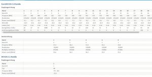

  • Fritzbox 6591 mit Gigabit - was ist hier los? Beitrag #720
  • Fritzbox 6591 mit Gigabit - was ist hier los? Beitrag #722
Möglichkeit 3: Mietbox schicken lassen und testen, ob die Probleme damit auch auftreten. Dann kann man immer noch eine Störung melden (ohne Damoklesschwert der Kosten wegen Eigengerät).
  • Fritzbox 6591 mit Gigabit - was ist hier los? Beitrag #723
ja mist die mietbox hab ich grade letzte woche zurück geschickt als der Brief mit dem DHL marke kam.. 🤬 ich frag mal den nachbarn ob er mal kurz seine VF station ausleihen kann und schau wie es da aussieht..
  • Fritzbox 6591 mit Gigabit - was ist hier los? Beitrag #724
Habe hier auch nur Probleme seit dem Zwangsupdate von Miet 6490 auf Miet 6591 (7.13) (120/6 Altvertrag). Seh ich das richtig, dass die Pegelwerte extrem schlecht sind? Nach einiger Zeit gehen die Fehler auf Kanal 4 extrem hoch. Dann bricht der Download auf nahezu null ein und manchmal erholt es sich von selbst. In den meisten Fällen hilft aber nur Stecker ziehen. Dann geht es manchmal für Tage wieder gut oder schon nach wenigen Stunden wieder los. Bild ist jetzt gerade nach dem Neustart entstanden.6591.jpg
  • Fritzbox 6591 mit Gigabit - was ist hier los? Beitrag #725
Dein Screenshot zeigt nur die ersten 19 Kanäle. Da sollten noch mehr zu sehen sein, wenn Du nach rechts scrollst. Die Powerlevel sind bei Dir IMO schon etwas gering. Besonders beim OFDM. Hier würde eine Anhebung dann auch einen besseren MSE bringen. Ich würde ne Störung melden ("Abbrüche bei Telefonat, Konferenzen etc") und den Anschluß neu einpegeln lassen.
