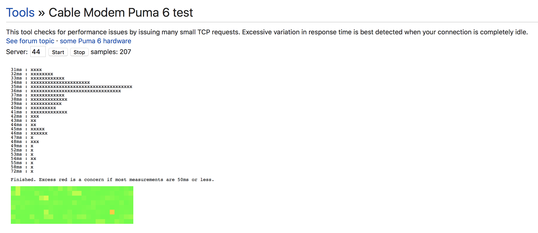

Auf gehts gegen das eigene Modem versuchen
https://github.com/nallar/Puma6Fail/releases/download/v0.5/puma6_fail.exe
$ md5sum puma6_fail.exe
30b2ef5140cc6cf7ff5d230ff93e4889 puma6_fail.exe
$ clamscan puma6_fail.exe
puma6_fail.exe: OK
:D
$ wine puma6_fail.exe
wine: Fehlerhaftes EXE-Format für Z:\usr\local\src\puma6_fail.exe.

Tja und der DOS exploit funktioniert nach paar Minuten gegen die Connect Box:
<i>
</i>$ iperf3 -c ping.online.net -p 5205 -t 500
[ 4] 12.00-13.00 sec 319 KBytes 2.61 Mbits/sec 0 164 KBytes
$ ./puma6fail 8.8.8.8
[ 4] 13.00-14.00 sec 19.2 KBytes 158 Kbits/sec 142 114 KBytes
[ 4] 14.00-15.00 sec 492 KBytes 4.03 Mbits/sec 78 67.4 KBytes
[ 4] 15.00-16.00 sec 308 KBytes 2.52 Mbits/sec 3 44.0 KBytes
[ 4] 16.00-17.00 sec 256 KBytes 2.09 Mbits/sec 0 48.1 KBytes
iperf3: error - unable to connect to server:
Sep 20 00:03:04 tom3 sflphoned: sipaccount.cpp:1981:0x29c0: Scheduling re-registration retry in 59 seconds..
Sep 20 00:03:35 tom3 sflphoned: sipaccount.cpp:1981:0x29c0: Scheduling re-registration retry in 309 seconds..
Sep 20 00:03:35 tom3 sflphoned: sipaccount.cpp:1981:0x29c0: Scheduling re-registration retry in 64 seconds..
Sep 20 00:04:34 tom3 sflphoned: sipaccount.cpp:1981:0x29c0: Scheduling re-registration retry in 296 seconds..
Sauerei solche Modems zu liefern, das können wir UM nicht durchgehen lassen, Modemgate, nachrüsten aber pronto! :wut:

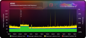

Irgendwie sieht das komisch aus. :kratz:
  • Intel Puma Plattform Beitrag #143
das die ping werte zwischen 0uhr und 3uhr höher sind, habe ich auch bei allen 4 meiner boxen (selber ort).
https://www.thinkbroadband.com/faq/broadband-quality-monitor
"RE-Sync"
Which routers support BQM?
Here is a list of routers which we have found, have been advised, or we believe are likely to (since models vary) support our BQM tool and a few we know do not:
Supported
Virgin Media Super Hub
Puma Bug device :D
Hier noch meine Connect Box LIVE
https://www.thinkbroadband.com/broadband/monitoring/quality/share/165312b34203bb79d96f21bb2d2e57db3d7dc87b
