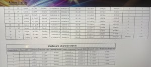

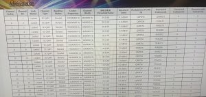

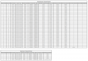

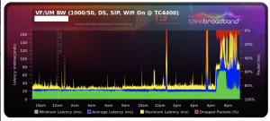

free8
53
Moin, habe gestern ein Router Update gemacht und heute Probleme mit der Bandbreite gehabt (Netflix HD-Streams haben Aussetzer). Habe natürlich ewig am Router rumgemacht, aber es scheint tatsächlich die Leitung zu sein.
Habe den Thinkbroadband Ping-Test laufen, sieht nicht gut aus.
Habe nun also mal in die Leitungswerte vom TC4400 geschaut:
Startup Procedure
Procedure
Status
Comment
Acquire Downstream Channel
482000000 Hz
Locked
Connectivity State
OK
Operational
Boot State
OK
Operational
Configuration File
OK
cust-own_1000000_50000_ds_sip_wifi-on.bin
Security
Enabled
BPI+
Downstream Channel Status
Channel Index
Channel ID
Lock Status
Channel Type
Bonding Status
Center Frequency
Channel Width
SNR/MER Threshold Value
Received Level
Modulation/Profile ID
Unerrored Codewords
Corrected Codewords
Uncorrectable Codewords
1
3
Locked
SC-QAM
Bonded
490000000 Hz
8000000 Hz
39.5 dB
2.7 dBmV
QAM256
4162140807
16484
1
Locked
SC-QAM
Bonded
474000000 Hz
8000000 Hz
39.8 dB
3.0 dBmV
QAM256
4155135692
10337
3
Locked
SC-QAM
Bonded
482000000 Hz
8000000 Hz
39.7 dB
2.8 dBmV
QAM256
4177129710
13017
7
4
4
Locked
SC-QAM
Bonded
498000000 Hz
8000000 Hz
39.2 dB
2.6 dBmV
QAM256
4177147810
20957
7
5
5
Locked
SC-QAM
Bonded
522000000 Hz
8000000 Hz
39.3 dB
2.6 dBmV
QAM256
4177129721
29301
7
6
6
Locked
SC-QAM
Bonded
530000000 Hz
8000000 Hz
39.5 dB
3.0 dBmV
QAM256
4177147874
26106
8
7
7
Locked
SC-QAM
Bonded
538000000 Hz
8000000 Hz
39.4 dB
3.2 dBmV
QAM256
4177160700
24904
7
8
8
Locked
SC-QAM
Bonded
546000000 Hz
8000000 Hz
39.4 dB
3.4 dBmV
QAM256
4177180707
23555
8
9
9
Locked
SC-QAM
Bonded
554000000 Hz
8000000 Hz
39.5 dB
3.6 dBmV
QAM256
4177187711
21883
7
10
10
Locked
SC-QAM
Bonded
562000000 Hz
8000000 Hz
39.5 dB
4.0 dBmV
QAM256
4177197465
19520
8
11
11
Locked
SC-QAM
Bonded
570000000 Hz
8000000 Hz
39.6 dB
4.0 dBmV
QAM256
4177225149
19219
7
12
12
Locked
SC-QAM
Bonded
578000000 Hz
8000000 Hz
39.5 dB
4.1 dBmV
QAM256
4177234074
19769
6
13
13
Locked
SC-QAM
Bonded
586000000 Hz
8000000 Hz
39.7 dB
4.3 dBmV
QAM256
4177245943
18434
7
14
14
Locked
SC-QAM
Bonded
594000000 Hz
8000000 Hz
39.5 dB
4.0 dBmV
QAM256
4177240479
20100
8
15
15
Locked
SC-QAM
Bonded
602000000 Hz
8000000 Hz
39.3 dB
4.1 dBmV
QAM256
4177258343
18487
7
16
16
Locked
SC-QAM
Bonded
618000000 Hz
8000000 Hz
39.5 dB
4.5 dBmV
QAM256
4177285955
17861
8
17
17
Locked
SC-QAM
Bonded
626000000 Hz
8000000 Hz
39.3 dB
4.4 dBmV
QAM256
4177275456
20824
8
18
18
Locked
SC-QAM
Bonded
634000000 Hz
8000000 Hz
39.3 dB
4.3 dBmV
QAM256
4177296884
20791
6
19
19
Locked
SC-QAM
Bonded
642000000 Hz
8000000 Hz
39.1 dB
4.2 dBmV
QAM256
4177281641
21138
7
20
20
Locked
SC-QAM
Bonded
650000000 Hz
8000000 Hz
39.0 dB
3.9 dBmV
QAM256
4177324768
19774
8
21
21
Locked
SC-QAM
Bonded
658000000 Hz
8000000 Hz
39.0 dB
3.9 dBmV
QAM256
4177322315
18718
7
22
22
Locked
SC-QAM
Bonded
666000000 Hz
8000000 Hz
39.0 dB
4.4 dBmV
QAM256
4177344876
17380
8
23
23
Locked
SC-QAM
Bonded
674000000 Hz
8000000 Hz
38.6 dB
4.1 dBmV
QAM256
4177356001
12109
7
24
24
Locked
SC-QAM
Bonded
682000000 Hz
8000000 Hz
38.7 dB
3.8 dBmV
QAM256
4177366598
11532
7
25
25
Locked
SC-QAM
Bonded
690000000 Hz
8000000 Hz
38.7 dB
3.6 dBmV
QAM256
4177371551
11142
7
26
26
Locked
SC-QAM
Bonded
698000000 Hz
8000000 Hz
38.7 dB
3.8 dBmV
QAM256
4177370121
10836
8
27
27
Locked
SC-QAM
Bonded
706000000 Hz
8000000 Hz
38.6 dB
4.2 dBmV
QAM256
4177381464
9721
7
28
28
Locked
SC-QAM
Bonded
746000000 Hz
8000000 Hz
38.1 dB
3.9 dBmV
QAM256
4177387919
5594
8
29
29
Locked
SC-QAM
Bonded
754000000 Hz
8000000 Hz
37.7 dB
3.6 dBmV
QAM256
4177393049
5164
8
30
30
Locked
SC-QAM
Bonded
762000000 Hz
8000000 Hz
37.5 dB
3.2 dBmV
QAM256
4177378567
4925
7
31
31
Locked
SC-QAM
Bonded
770000000 Hz
8000000 Hz
37.5 dB
3.5 dBmV
QAM256
4177399910
1956
8
32
32
Locked
OFDM
Bonded
823000000 Hz
86000 kHz
32.5 dB
-2.4 dBmV
0,1,2
3435346748
2472722574
820448013
Upstream Channel Status
Channel Index
Channel ID
Lock Status
Channel Type
Bonding Status
Center Frequency
Channel Width
Transmit Level
1
1
Locked
SC-QAM
Bonded
30800000 Hz
6400000 Hz
45.0 dBmV
ATDMA
Locked
SC-QAM
Bonded
37200000 Hz
6400000 Hz
45.0 dBmV
ATDMA
3
3
Locked
SC-QAM
Bonded
44600000 Hz
6400000 Hz
45.0 dBmV
ATDMA
4
4
Locked
SC-QAM
Bonded
51000000 Hz
6400000 Hz
45.0 dBmV
ATDMA
5
5
Locked
OFDMA
Bonded
50725000 Hz
10400 kHz
36.0 dBmV
3, 4, 9, 10, 11, 12, 13
CM IP Address
Duration
Expires
IPv4=10.***.**.**
D: 03 H: 00 M: 00 S: 00
Tue Jan 19 **:**:** 2021
IPv6=
Current System Time: Sat Jan 16 22:11:51 2021
Der OFDM war schon immer nix hier (hier habe ich vor nem halben Jahr schon mal die Werte geteilt). Aber die (wenn auch wenigen) Uncorrectables bei den anderen Channels sind neu, da war ich sonst immer bei 0. Die Signalstärke ist auch 2-3 dB gewachsen, deutet das auf irgendwas hin? Habe nebenan ne Großbaustelle, könnt ggfs. etwas getroffen worden sein?
Ah gemäß Speedtest-API gibts keine plannedImprovements ("null"). Das TC ist auf Version 70.12.41-180903.
Danke im Voraus für einen Blick auf die Werte und viele Grüße Nils

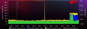

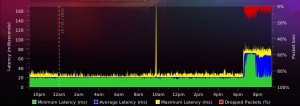

Technicolor TC4400 Docsis 3.1 Modem Info Thread Beitrag #9.338
__QT__
1.502
347
Interessant. Mein TBB BQM sieht seit heute Abend nach 18 Uhr sehr sehr ähnlich aus. Hatte mich eben auch schon gewundert, was da los ist...
Technicolor TC4400 Docsis 3.1 Modem Info Thread Beitrag #9.339
toppi
251
19
Sehr merkwürdig,
meine Leitung ist zwar chronisch scheiße, aber hier auch ein ähnlicher effekt.
Technicolor TC4400 Docsis 3.1 Modem Info Thread Beitrag #9.340
__QT__
1.502
347
Der Effekt scheint wieder vorbei. Der BQM Graph normalisiert sich wieder...
Technicolor TC4400 Docsis 3.1 Modem Info Thread Beitrag #9.341
Crazyhorse
56
7
Hier wird wohl auch geschraubt, ging nach 19 Uhr los und der Ping RTT von 27-28 auf 57-58ms hoch. Seit 22:30 aber wieder ok, lost war in der Zeit ca. 10%. Der Peak um 22 Uhr war ich, habe den Vorverstärker umgesteckt.
Technicolor TC4400 Docsis 3.1 Modem Info Thread Beitrag #9.342
free8
53
Tatsächlich, hier ist seit ca. 23 Uhr ebenfalls wieder alles normal. War wohl keine lokale Geschichte...
Immer passiert sowas wenn man am Vortag was anderes geändert hat -.-
Danke für die Berichte & schönen Abend!

geforce28
10
Mahlzeit.
Ich habe bei mir zu Hause die Multimedia Dose selbst umgelegt und das Modem ist in einen anderen Raum eingezogen... *schäm...* Scheint auch alles zu funktionieren..
Hier mal die Werte des TC4400... Genutzt habe ich eine Axing Durchgangsdosedose mit 12DB Dämpfung..
Kann ich das ganze so lassen, oder noch n Dämpfungglied oder so dazwischen ?
Technicolor TC4400 Docsis 3.1 Modem Info Thread Beitrag #9.345
Pegel steigen zu hohen Frequenzen etwas zu stark an. Könnte man im Verstärker durch Umstecken von Jumpern korrigieren. Aber, weil die sonstigen Werte eigentlich o.k. sind, würde ich es so lassen...

Magulan
14
3
Eben habe ich festgestellt, dass mir ein Upstream fehlt (Partial Service). Daraufhin das Modem neu gestartet und siehe da, hier (Heidelberg) wurde ein OFDM im Upstream geschaltet. Den Pegel finde ich jetzt aber etwas niedrig, oder ist der OK so? Kennt jemand den Grenzwert des OFDM im Upstream?
Technicolor TC4400 Docsis 3.1 Modem Info Thread Beitrag #9.350
A 6 dB difference in power is normal (when the spectrum is flat), due to how the power is reported in the web interface. The power in the SC-QAM channels is reported across 6.4 MHz, whereas the power in the OFDMA channel is reported across 1.6 MHz. That is a 4x difference in bandwidth, which equals a 6 dB difference in power.
