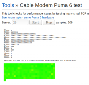

Hier noch ein paar Messungen der UM Box vs. Arris Modem
UM BOX :
iperf3 -c ping.online.net -p 5207 -R -u -t10 -b18M
Connecting to host ping.online.net, port 5207
Reverse mode, remote host ping.online.net is sending
[ 4] local 192.168.10.17 port 57703 connected to 62.210.18.40 port 5207
[ ID] Interval Transfer Bandwidth Jitter Lost/Total Datagrams
[ 4] 0.00-1.00 sec 1.73 MBytes 14.5 Mbits/sec 2.566 ms 47/269 (17%)
[ 4] 1.00-2.00 sec 1.99 MBytes 16.7 Mbits/sec 2.591 ms 19/274 (6.9%)
[ 4] 2.00-3.00 sec 1.67 MBytes 14.0 Mbits/sec 2.685 ms 59/273 (22%)
[ 4] 3.00-4.00 sec 1.95 MBytes 16.3 Mbits/sec 2.530 ms 27/276 (9.8%)
[ 4] 4.00-5.00 sec 1.77 MBytes 14.9 Mbits/sec 2.251 ms 49/276 (18%)
[ 4] 5.00-6.00 sec 2.02 MBytes 16.9 Mbits/sec 2.589 ms 14/272 (5.1%)
[ 4] 6.00-7.00 sec 1.81 MBytes 15.2 Mbits/sec 3.192 ms 40/272 (15%)
[ 4] 7.00-8.00 sec 2.01 MBytes 16.8 Mbits/sec 2.194 ms 23/280 (8.2%)
[ 4] 8.00-9.00 sec 1.84 MBytes 15.5 Mbits/sec 2.444 ms 37/273 (14%)
[ 4] 9.00-10.00 sec 1.92 MBytes 16.1 Mbits/sec 2.275 ms 29/275 (11%)
ARRIS :
[ 4] local 192.168.10.17 port 50729 connected to 62.210.18.40 port 5207
[ 4] 0.00-1.00 sec 1.99 MBytes 16.7 Mbits/sec 0.196 ms 20/275 (7.3%)
[ 4] 1.00-2.00 sec 2.15 MBytes 18.0 Mbits/sec 0.163 ms 0/275 (0%)
[ 4] 2.00-3.00 sec 2.15 MBytes 18.1 Mbits/sec 0.146 ms 0/275 (0%)
[ 4] 3.00-4.00 sec 2.14 MBytes 18.0 Mbits/sec 0.183 ms 0/274 (0%)
[ 4] 4.00-5.00 sec 2.15 MBytes 18.0 Mbits/sec 0.127 ms 0/275 (0%)
[ 4] 5.00-6.00 sec 2.15 MBytes 18.0 Mbits/sec 0.142 ms 0/275 (0%)
[ 4] 6.00-7.00 sec 2.14 MBytes 18.0 Mbits/sec 0.144 ms 0/274 (0%)
[ 4] 7.00-8.00 sec 2.15 MBytes 18.0 Mbits/sec 0.133 ms 0/275 (0%)
[ 4] 8.00-9.00 sec 2.15 MBytes 18.0 Mbits/sec 0.169 ms 0/275 (0%)
[ 4] 9.00-10.00 sec 2.07 MBytes 17.4 Mbits/sec 0.138 ms 9/274 (3.3%)
iperf Done.
  • Screenshot_2019-04-26_Cable_modem_Puma_6_chipset_test_DSLReports,_ISP_Information.png
