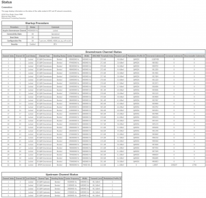

Jetzt hat es mich auch befallen, das OFDM Virus:
Status
Connection
This page displays information on the status of the cable modem's HFC and IP network connectivity.
CM IP Prov Mode: Honor MDD
Ethernet Wan Mode:
Bidirectional Forwarding Detection:
Startup Procedure
Procedure Status Comment
Acquire Downstream Channel 530000000 Hz Locked
Connectivity State OK Operational
Boot State OK Operational
Configuration File OK "cust-own_150000_20000_ds_sip_wifi-on.bin"
Security Enabled BPI+
Downstream Channel Status
Channel Index Channel ID Lock Status Channel Type Bonding Status Center Frequency Width SNR/MER Threshold Value Receive Level Modulation/Profile ID Unerrored Codewords Corrected Codewords Uncorrectable Codewords
1 6 Locked SC-QAM Downstream Bonded 530000000 Hz 8000000 Hz 38.1 dB 3.6 dBmV QAM256 762258402 4 0
2 1 Locked SC-QAM Downstream Bonded 474000000 Hz 8000000 Hz 38.0 dB 3.3 dBmV QAM256 761516068 1 0
3 2 Locked SC-QAM Downstream Bonded 482000000 Hz 8000000 Hz 37.9 dB 3.3 dBmV QAM256 761519072 2 0
4 3 Locked SC-QAM Downstream Bonded 490000000 Hz 8000000 Hz 38.3 dB 3.6 dBmV QAM256 761521265 1 0
5 4 Locked SC-QAM Downstream Bonded 498000000 Hz 8000000 Hz 38.6 dB 3.9 dBmV QAM256 761524039 2 0
6 5 Locked SC-QAM Downstream Bonded 522000000 Hz 8000000 Hz 38.3 dB 3.5 dBmV QAM256 761527024 3 0
7 7 Locked SC-QAM Downstream Bonded 538000000 Hz 8000000 Hz 38.2 dB 3.9 dBmV QAM256 761529799 1 0
8 8 Locked SC-QAM Downstream Bonded 546000000 Hz 8000000 Hz 38.8 dB 4.7 dBmV QAM256 761530259 0 0
9 9 Locked SC-QAM Downstream Bonded 554000000 Hz 8000000 Hz 38.7 dB 5.1 dBmV QAM256 761535035 2 0
10 10 Locked SC-QAM Downstream Bonded 562000000 Hz 8000000 Hz 38.6 dB 5.1 dBmV QAM256 761537649 0 0
11 11 Locked SC-QAM Downstream Bonded 570000000 Hz 8000000 Hz 38.5 dB 5.1 dBmV QAM256 761540362 2 0
12 12 Locked SC-QAM Downstream Bonded 578000000 Hz 8000000 Hz 38.8 dB 5.7 dBmV QAM256 761544692 1 0
13 13 Locked SC-QAM Downstream Bonded 586000000 Hz 8000000 Hz 38.8 dB 6.2 dBmV QAM256 761559968 1 0
14 14 Locked SC-QAM Downstream Bonded 594000000 Hz 8000000 Hz 38.5 dB 5.5 dBmV QAM256 761563662 3 0
15 15 Locked SC-QAM Downstream Bonded 602000000 Hz 8000000 Hz 38.4 dB 5.2 dBmV QAM256 761567048 2 0
16 16 Locked SC-QAM Downstream Bonded 618000000 Hz 8000000 Hz 38.1 dB 4.7 dBmV QAM256 761569619 1 0
17 17 Locked SC-QAM Downstream Bonded 626000000 Hz 8000000 Hz 38.6 dB 5.1 dBmV QAM256 761574247 0 0
18 18 Locked SC-QAM Downstream Bonded 634000000 Hz 8000000 Hz 38.4 dB 5.1 dBmV QAM256 761577121 1 0
19 19 Locked SC-QAM Downstream Bonded 642000000 Hz 8000000 Hz 38.3 dB 4.4 dBmV QAM256 761579345 1 0
20 20 Locked SC-QAM Downstream Bonded 650000000 Hz 8000000 Hz 38.3 dB 4.5 dBmV QAM256 761581938 2 0
21 21 Locked SC-QAM Downstream Bonded 658000000 Hz 8000000 Hz 38.3 dB 4.9 dBmV QAM256 761584765 2 0
22 22 Locked SC-QAM Downstream Bonded 666000000 Hz 8000000 Hz 38.1 dB 4.7 dBmV QAM256 761586958 0 0
23 23 Locked SC-QAM Downstream Bonded 674000000 Hz 8000000 Hz 37.9 dB 4.3 dBmV QAM256 761590307 0 0
24 24 Locked SC-QAM Downstream Bonded 682000000 Hz 8000000 Hz 37.9 dB 4.4 dBmV QAM256 761593008 0 0
25 25 Locked SC-QAM Downstream Bonded 690000000 Hz 8000000 Hz 37.8 dB 4.7 dBmV QAM256 761595870 4 0
26 26 Locked SC-QAM Downstream Bonded 698000000 Hz 8000000 Hz 38.0 dB 4.8 dBmV QAM256 761596405 1 0
27 27 Locked SC-QAM Downstream Bonded 706000000 Hz 8000000 Hz 38.1 dB 4.7 dBmV QAM256 761602083 1 0
28 28 Locked SC-QAM Downstream Bonded 746000000 Hz 8000000 Hz 37.0 dB 3.2 dBmV QAM256 761604554 6 0
29 29 Locked SC-QAM Downstream Bonded 754000000 Hz 8000000 Hz 36.6 dB 2.4 dBmV QAM256 761607618 13 0
30 30 Locked SC-QAM Downstream Bonded 762000000 Hz 8000000 Hz 36.9 dB 3.4 dBmV QAM256 761609755 6 0
31 31 Locked SC-QAM Downstream Bonded 770000000 Hz 8000000 Hz 36.7 dB 2.7 dBmV QAM256 761611079 16 0
32 32 Locked OFDM Downstream Bonded 786000000 Hz 46000 kHz 31.8 dB -0.7 dBmV 0 7868778 909200 81369
Upstream Channel Status
Channel Index Channel ID Lock Status Channel Type Bonding Status Center Frequency Width Transmit Level Modulation/Profile ID
1 83 Locked SC-QAM Upstream Bonded 58400000 Hz 6400000 Hz 49.0 dBmV 2
2 79 Locked SC-QAM Upstream Bonded 30800000 Hz 6400000 Hz 45.8 dBmV 2
3 80 Locked SC-QAM Upstream Bonded 37400000 Hz 6400000 Hz 46.5 dBmV 2
4 81 Locked SC-QAM Upstream Bonded 45200000 Hz 6400000 Hz 47.0 dBmV 2
5 82 Locked SC-QAM Upstream Bonded 51800000 Hz 6400000 Hz 47.8 dBmV 2
3 Tage ohne funktionierende Verbindung, nun geht es wieder.
Am Montag soll ein Techniker kommen, der Termin war schon vereinbart.
Optionen:
1) Techniker absagen, erst einmal beobachten, nichts tun
2) Sperrfilter dazwischenschalten (liegt hier schon rum, hatte ich mal auf Verdacht besorgt)
3) Techniker kommen lassen ( und was wird/soll der dann tun? )
TC4400 ist erste Charge, noch mit SR70.12.20

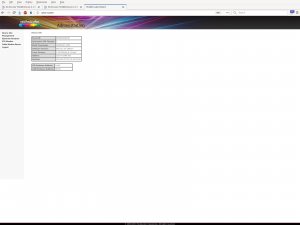

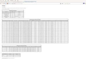

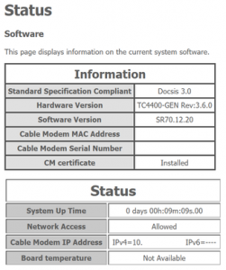

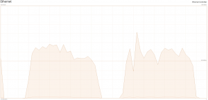

mein TC4400 zeigt seit Aufschaltung des OFDM nun auch unschönes Verhalten. So bricht der Download alle paar Sekunden auf wenige Kbps oder sogar 0 herunter. Wireshark zeigt hier dupplicate acks bei TCP, also bleiben wohl ein paar Pakete auf der Strecke :traurig: Das Verhalten bleibt auch bei direktem Anschluss am Modem (ohne Firewall, mit anderem Computer plus Kabel sowie Neustart des Modems) bestehen.
Die folgenden Lösungsansätze blieben leider erfolglos:
TC4400 OFDM Kanal deaktivieren
Mit .33 Labor und der .20 Firmware! Problem war jetzt nur noch dass ich mit dem Ubuntu PC das gemacht habe und danach ja meine pfSense damit benutzen möchte. Folgender Ablauf:
1. Modem ausschalten.
2. Coaxkabel abziehen.
3. Client mit Ubuntu inkl. SNMP Paket anschließen.
4. Modem einschalten und kurz warten.
5. Terminal auf Ubuntu starten und folgendes eingeben: snmpset -v2c -c public 192.168.100.1 1.3.6.1.4.1.46366.4292.77.1.307.0 i 2
6. Client mit Ubuntu abstecken und Router/Zielclient anschließen
7. Coaxkabel anstecken und freuen.
<i>
</i>- snmpset -v2c -c public 192.168.100.1 1.3.6.1.4.1.46366.4292.77.1.307.0 i 1
- Kein Filter
- Modem normal starten mit angeschlossenem Coax
- Warten bis es Online ist
- Internet wie beschrieben kaum nutzbar
- Coaxkabel abziehen
- 5 Sekunden warten
- Coaxkabel wieder dran stecken
- Paar Sekunden warten.
- Internet funktioniert ohne Probleme (Fullspeed, kein Paketloss, normale Pings)
Hier noch die Leitungswerte:
Für mich sieht das nach einem Fall für den Techniker aus, aber falls hier jemand eine Idee hat was man noch versuchen könnte würde mich das freuen :smile:

  • Technicolor TC4400 Docsis 3.1 Modem Info Thread Beitrag #6.668
Die Werte sehen nicht so schlecht aus. Evtl. wird auf dem OFDM aber noch nichts übertragen. Ich würde mal etwas abwarten, leider dauert die Einmessung teils ein wenig. Aber klar, frisch einpegeln schadet natürlich nie.
Die Ausblendung funktioniert nur wenn der OFDM zu schlecht ist um zu bonden.
Gut zu wissen, danke! :smile:
Also zumindest der Zähler des OFDM geht fleißig nach oben:
<i>
</i>Unerrored Codewords	Corrected Codewords	Uncorrectable Codewords	126.907 3.356.297 17.706	163.746	22.340.496	117.334
Die Aufschaltung des OFDM war am 18.09. Jetzt ist die Frage ob man da auf Godot wartet oder sich wirklich noch etwas in den nächsten ein, zwei Wochen tut.

fuer alle, die beim melden einer stoerung dazu aufgefordert werden, die schwankungen durch speedtest.unitymedia.de zu protokolieren, der speedtest ist augenwischerei. lasst euch ueber den task manager oder einem genaueren tool, den tatsaechlichen datenfluss anzeigen. der unitytest nimmt nur den anfaenglichen spitzenwert, selbst wenn dieser nur mit ach und krach fuer eine sekunde auf den wert des gebuchten tarifs kommt, wird dieser als testergebnis angezeigt. das uebertragene datenpaket ist erstens viel zu klein fuer eine genaue messung und zum anderen werden schwankungen von diesem test allem anschein nachgarnicht wirklich erfasst.
habe dann waerend des telefonats mit der hotline einen download mit 20 verbindungen zu verschiedenen servern laufen lassen und mit diesen werten/verlauf argumentiert, woraufhin er ein ticket erstellt hat.
scheint aber auch nicht wirklich was gebracht zu haben. es sollte sich spaetestens am naechsten tag jemand melden, das ist nun 3 tage her.
gucken wie es weitergeht...
